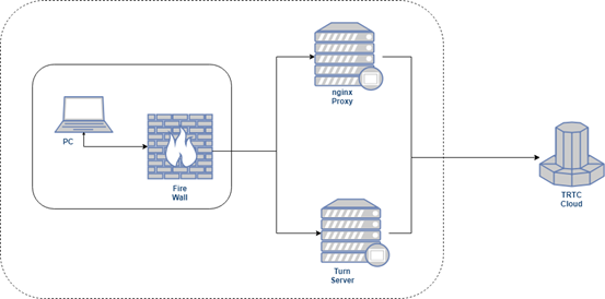

| Scheme 1 | Allows your webpages to access specific external proxy servers. | Set up the proxy servers outside your corporate network and add the proxy servers to your firewall allowlist. |

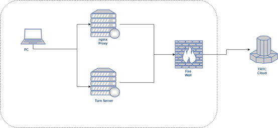

| Scheme 2 | Allows your webpages to access public networks through internal proxy servers. | Set up the proxy servers inside your corporate network and allow the proxy servers to access the TRTC server. |

Scheme 1
Set up the NGINX server
              Deploy an NGINX server Refer to tutorials on the internet to set up and deploy an NGINX server for your company.
              Configure the NGINX server. vi /etc/nginx/nginx.confhttp { server { # The domain of the NGINX server server_name proxy.example.com; # The port number of the NGINX server listen 443; ssl on; location /ws/ { # The `websocketProxy` parameter in `setProxyServer` proxy_pass https://intl-signaling.rtc.qcloud.com/; # The TRTC server proxy_http_version 1.1; proxy_set_header Upgrade $http_upgrade; proxy_set_header Connection "upgrade"; } location /logger/ { # The `loggerProxy` parameter in `setProxyServer` proxy_pass https://videoapi-sgp.im.qcloud.com/; } # The SSL certificate of the domain, which you need to obtain by yourself ssl_certificate ./crt/1_proxy.trtcapi.com_bundle.crt; ssl_certificate_key ./crt/2_proxy.trtcapi.com.key; } }
              Reload NGINX. sudo nginx -s reload
              Check that the IP address and port of the NGINX server are no longer blocked by your corporate firewall.

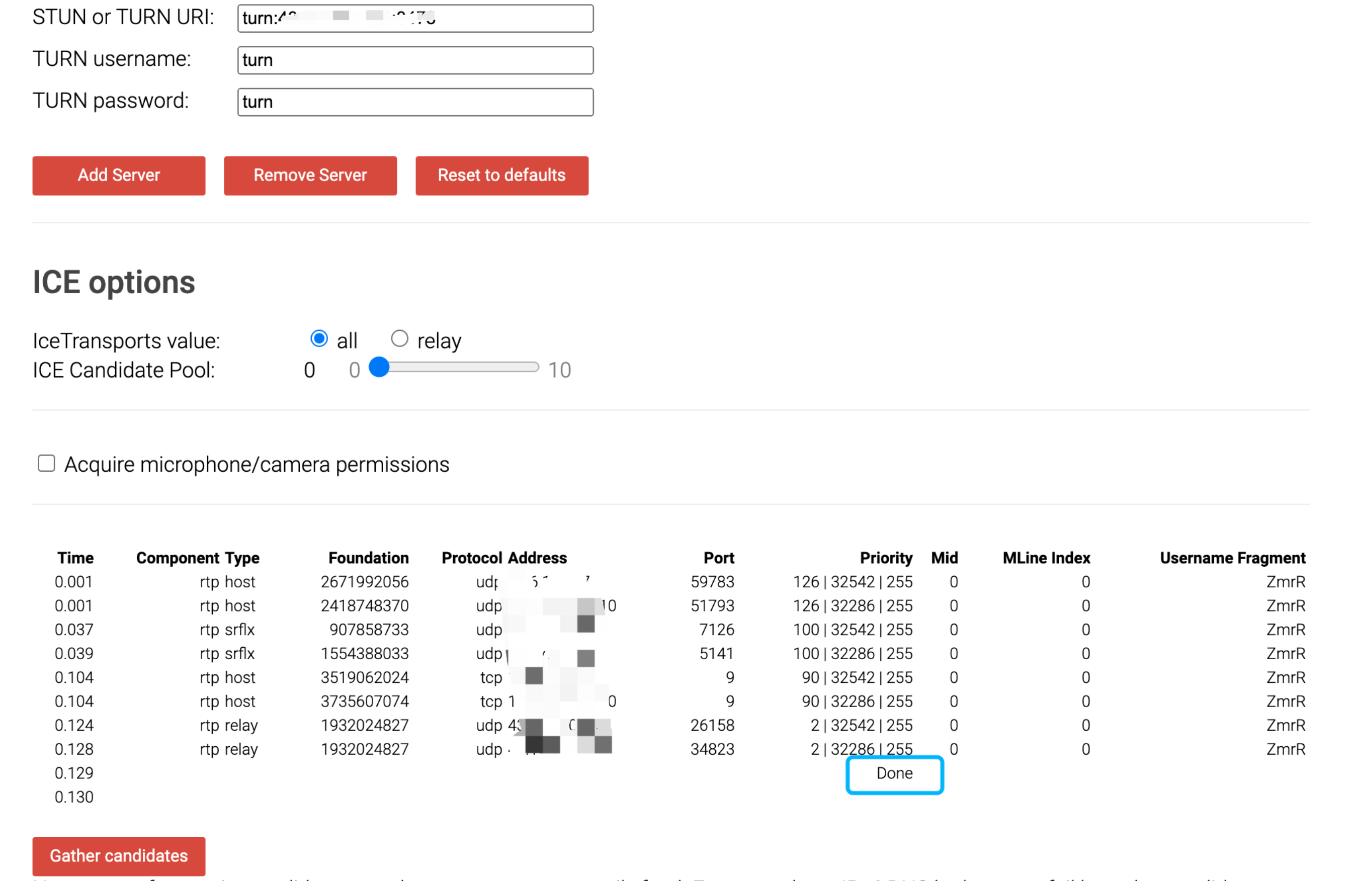

              Test the TURN server. Use this test page to test whether you can access the TURN server. "done" indicates that the TURN server is accessible.
Scheme 2
Scheme 2 differs from scheme 1 only in terms of two settings.
- When setting up the TURN server, set external-ipto a server address in your corporate network.
# In scheme 1, the parameter is set to a server address in a public network, such as `14.3.3.3`.
sudo ./turn.sh 14.3.3.3
# In scheme 2, the parameter is set to a server address in your corporate network, such as `10.0.0.4`.
sudo ./turn.sh 10.0.0.4
- Configure the firewall:
- Allow the NGINX server to access TRTC domains. For information about the ports and domain names used by the TRTC web SDK, see Firewall Restrictions.
- Allow the TURN server to access public networks.
