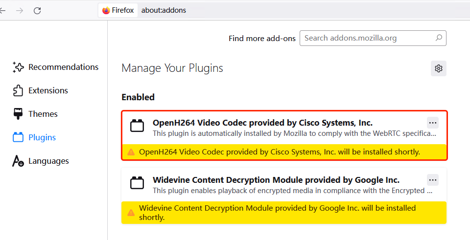

  2. The first installation of Firefox will dynamically install the H.264 codec while connected to the Internet. SDK connot publish and subscribe stream until the installation is completed. Suggestions:
    • Use TRTC.checkSystemRequirements API, if it detects that H264 codec is not supported in Firefox, guide the user to open the address: about:addons in Firefox and check the installation of OpenH264 in the Plugin. Wait for the installation to complete before making the call.
